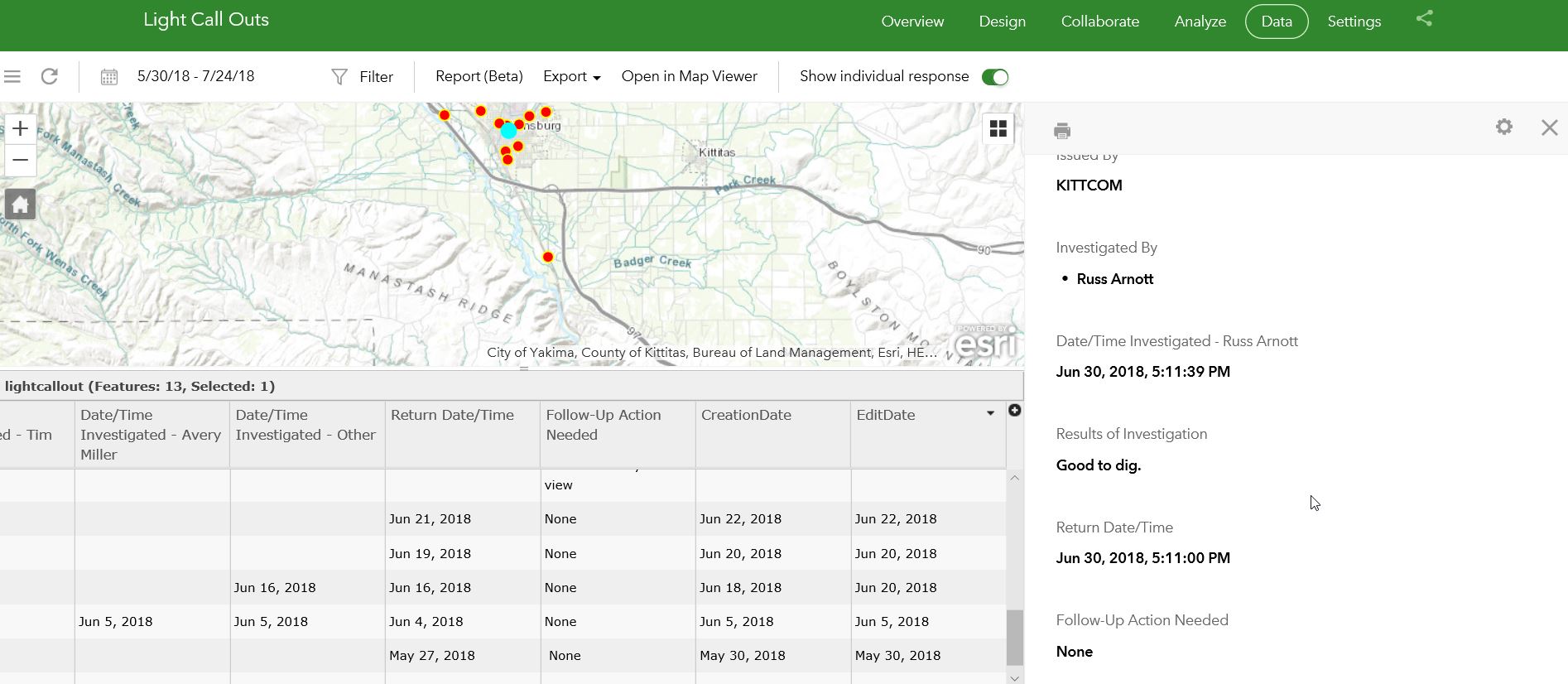

In all the date/time fields in the spreadsheet below we can't see the time when viewing in the Data tab spreadsheet on the web interface. It shows when we click on the individual response and in every other format (exported files, when opening in map viewer, etc.). Is there a way to turn it on? Or can someone tell me if I'm missing something?

Hi Michelle,
Thanks for the feedback. Ideally, we should display the value of a date question in a survey as date only format and the value of a datetime question in a survey as date+time format. This is something we can work on in the next 3.1 release.
