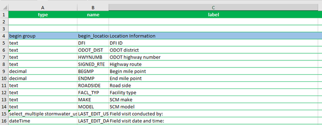

3.   In Survey123 Connect, I created a form based solely on the attribute fields in the relate table. I wanted all the edits and its submission to go straight into the relate table and not the parent layer.

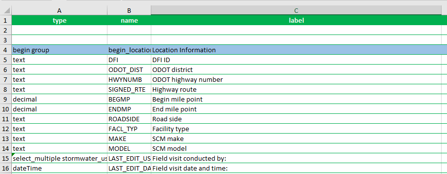

To create survey123 data in the relate table without creating a new record in the parent layer, I changed the form ID reference from the parent layer to the relate table:
and removed any reference to the relate table, at the beginning and end, in the survey123 XLS survey tab:
This setup seems to work great for creating relate records to an existing record in the parent layer without creating a new record in the parent when submitting the form in survey123.
