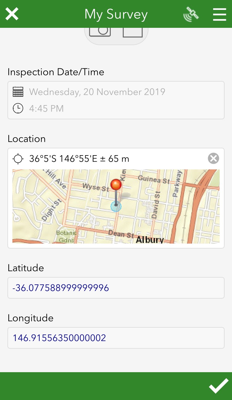

We have a geopoint type question in a Survey123 form, and currently it is using a default basemap like this:
The user would like to see other feature layers displayed in this Location window, we have created a map in AGOL, is there a way we can specify which map to use as the basemap, just as we can in Report generation etc?

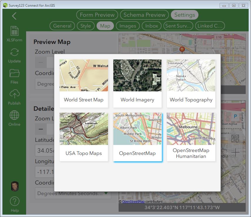

I note we can use other ESRI Basemaps, but I cannot see my own maps in this list.

Hi Ben,
Yes, this is currently possible as a Beta feature in Survey123 using the Standard map types option available in the Settings menu under Map options. You will need to enable this setting in both Connect and the field app, and then you can use the Linked Content option in Connect for that survey to link a web map to your survey.
The web map is then added as a basemap in the basemap chooser for a geopoint question. You can also select it as the default in Connect for all map questions in the survey or set it as a default for a specific geopoint question only in the xlsx file using the body::esri:style column.
You can find more information about including a map in your survey and the defaults in the documentation here: Include a map in your survey—Survey123 for ArcGIS | Documentation
And please refer to the documentation on EAC for beta features and Standard map types: https://earlyadopter.esri.com/project/article/item.html?cap=e69ef91f45744b98882c651f7b518eb7&arttype...
All users using the survey will need to have Standard map types enabled if you want them to use the web map as the basemap.
