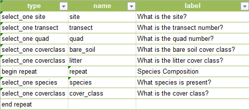

I have a repeat question in my survey as shown below.
The repeat question is to document the plant species and cover class in a quadrat.  There are over 200 values for plant species and many species may be found in a quadrat.  Is there a way to prevent a plant species from accidentally submitted multiple times in the repeat question?

I think your issue is the Other.  That will repeat a bunch of times.
I do this exact thing with species actually.  We use Unknown Codes but same concept.  You will have to build in an exception for the Other.
I did not test it but I added my line into your form.  You could change my exceptions from UNK to Other.

Hi Lauren,
It is possible to create a check function using an in-beta function, custom JavaScript functions. See the attached sample.

Hi Lauren,
In the survey is a custom function that compares the number of answers with the number of distinct answers and returns true if they are the same and false if they are not.  I based it on https://codeburst.io/javascript-array-distinct-5edc93501dc4

Hi Lauren,
The pulldata expression needs to be in its own hidden calculation, and then reference that question name in your relevant expression for the note.
It will not work the way you have currently tried to use it in the note.

Hi Lauren,
No, this is not correct. You need to remove the not and separate that to a different question from the pulldata.
Can you attach your xslx file so I can take a closer look and work out the best way to achieve what you are after.
