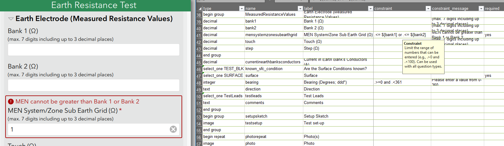

I have a required field to record M.E.N. Resistance in Ohms.
I also have another two optional fields for Bank1 resistance and Bank2 resistance (Ohms).
Condition is M.E.N. cannot be greater than Bank1 or Bank2.
When Bank1 and/or Bank2 is empty, entering any value in M.E.N. will obviously be greater than Bank1 and/or Bank2.
Can I put an IF statement in the Constraint column?

I'm showing my lack of programming skills, then, by asking how I would write an expression. So far I have come up with:
if(${bank1} != NaN, .<= ${bank1}, if(${bank2} != NaN, .<= ${bank2}, ''))
Which means: if bank1 is not 'not a number' then constrain to less than or equal to bank1, if bank2 is not 'not a number' then constrain to less than or equal to bank2, else do not constrain.
bank1 and bank2 are decimal fields, as is the M.E.N. field.
Am I on the right track? Probably not, because I get this:
Because both bank1 and bank2 are NaN, any value in MEN should be acceptable. A condition should only be applied if either bank1 or bank2 have a number.

RogerFarmer1
Hi Phil,
I tried it and it hasn't quite worked. The constraint is still applied when both bank1 and bank2 are empty.
The above should be OK.
The above should also be OK because MEN is no higher than bank2.
Regards,
Roger

As for your second screenshot above, this does not make sense when compared with the message you display. The constraint message says that:
MEN cannot be greater than Bank 1 or Bank 2
In your example, Blank1 is "1", Blank2 is "1.1" and the MEN value is "1.1". This will cause the constraint to be true, as 1.1 is greater than 1. This occurs because we used an "and" statement in the expression were both Blank1 and Blank2 had values. If you want it to be an either or constraint, you then need to use an "or" statement. However for me, the constraint message is not clear in this case, as the way it reads would mean that MEN should not be greater than both the values, not just one or the other. In that case use the following expression with an "or" in the second if statement:
