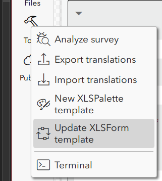

What version is your Connect? If it is more recent, you can go to Tools > Update XLSForm template
That will give you all the fancy new options!
