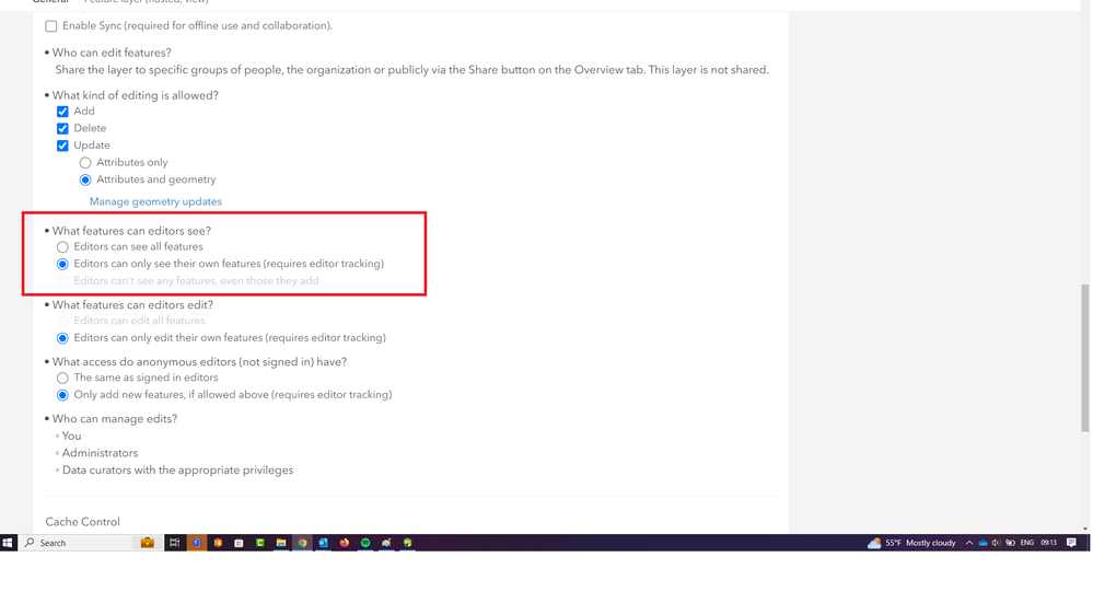

I bet the layer you are using to populate the list is configured like shown below:
Make sure you check 'Editors can see all features' and your survey will start working as you planned.

Thanks for the suggestion Ismael. Can you please indicate where to find those options? Is it on the Survey123 website? I can't see it, but did change the 'Who can view results of this survey' to 'Everyone' in the Collaborate tab of the Survey123 website (see photo). I made sure to select that viewers can see all records (nor just their own). This has not fixed the problem.
