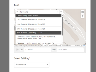

We have a service request form that was created using Survey123 Connect. It contains a mini map that is linked to a custom built ESRI web map in our ArcGIS Enterprise Portal. The search bar in this mini map uses our custom built geocoder to pull suggestions. As I have recently found out, all ESRI web maps are defaulted to 6 suggestion results for the search bar. So far, I have not found a way to configure the web map to increase the number of suggestions. I also asked my administrator for the enterprise portal and he confirmed there is no setting to configure the search bar in a web map.
To compensate for this, I built the same web map we were using for the Survey123 form in Instant App. When building a web map in Instant App, you are allowed to configure geocoder settings and suggestion settings for the search bar in the web map. I have set the default number of suggestions to 25.
Is there a way to use this Instant App web map as the link for the mini map in the Survey123 form? Can this possibly be configured either in the Survey123 Connect settings or the XLSform?

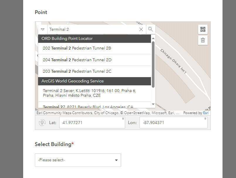

Below is an example of what suggestions is currently doing in the Survey123 form. Only 6 suggestions show up at a time. 3 for our building point locator and 3 for the WGS. We need the client to be able to see ALL suggestions for a particular value, in this case, terminals.
