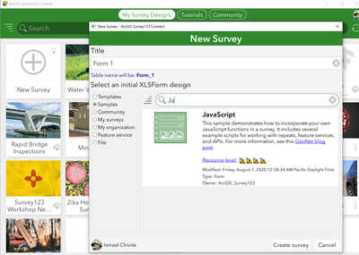

GordonSumerling
Thank you zkovacs, I actually found a good article by @IsmaelChivite after posting  this question Custom JavaScript functions in Survey123 (esri.com)
This describes what I need to do and also there is sample in the Survey123 connect which helps
