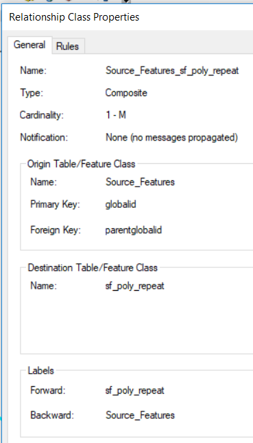

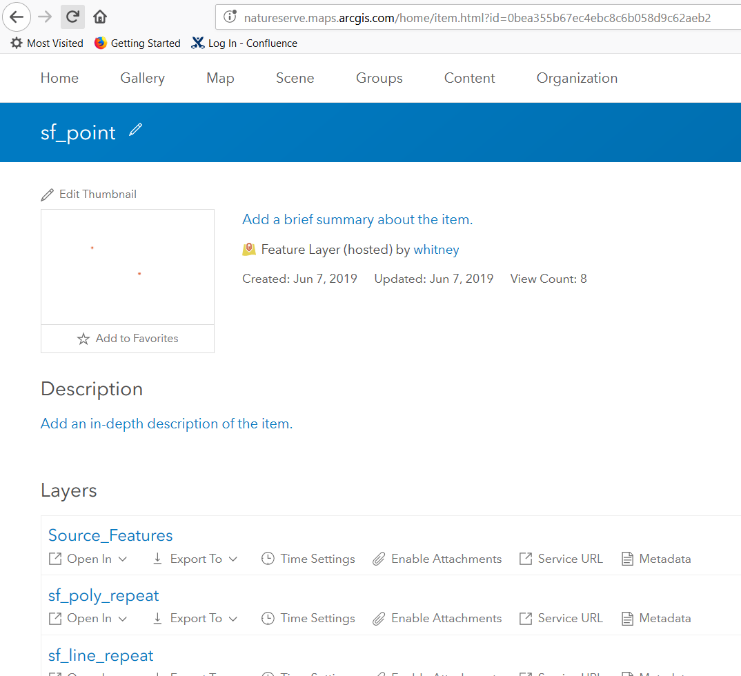

I am trying to call Collector via a survey in Survey123 to collect polygons and lines. Attached is a document (old screenshots) with the detailed process as well as my spreadsheet, but following is an overview of the steps I took:
So, I'm still at square one with no way to relate my line and polygon data to my original survey.
Somebody please take pity on me and tell me what I am missing!

The only way I know to create a unique id is by creating a GUID field. I did that and it still doesn't pass to Collector. Following is the syntax I'm using - is my syntax wrong? If so, please suggest the correct syntax! parentglobalid is the field name in the polygon fc being collected via Collector and UniqueSurveyID is the field in the survey.
<a href="arcgis-collector://?itemID=9f23ea7ae9bd4456b5c9d522a1ce6e4c&featureSourceURL=https://services.arcgis.com/EVsTT4nNRCwmHNyb/arcgis/rest/services/Source_Features_Collector/FeatureServer/2&featureAttributes=%7B%22parentglobalid%22:UniqueSurveyID%7D">Map a Polygon</a>
