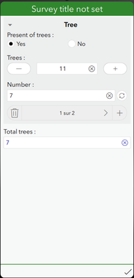

When users were filling out the survey recently, they noticed that moving back and forth between repeats to make corrections locked the calculations and the totaled sums could no longer be updated. I have tried calculationMode = always.

This "refresh" button indicates that either someone typed into the field, or something more annoying is going on (could be a few vague things...). Clicking the button should show the correct values.

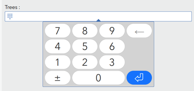

  2. Repeats are annoying for calculations. In very general terms, when the last thing in a repeat is a number needed for a calculation, the user needs to manually press "enter" for the calculation to trigger. Entering the value and then immediately going to the next tab skips that step and required them to go "back" and then "forward" in the repeat for the calculate to work. A more elegant solution is to use the "numbers" appearance. This does everything for you, ensuring the value is entered and the calculate triggers.

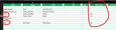

Try this:
Not sure why the way you had it setup didn't work?

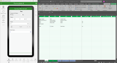

SébastienDebar
It makes no difference, on the Connect or on my phone.
