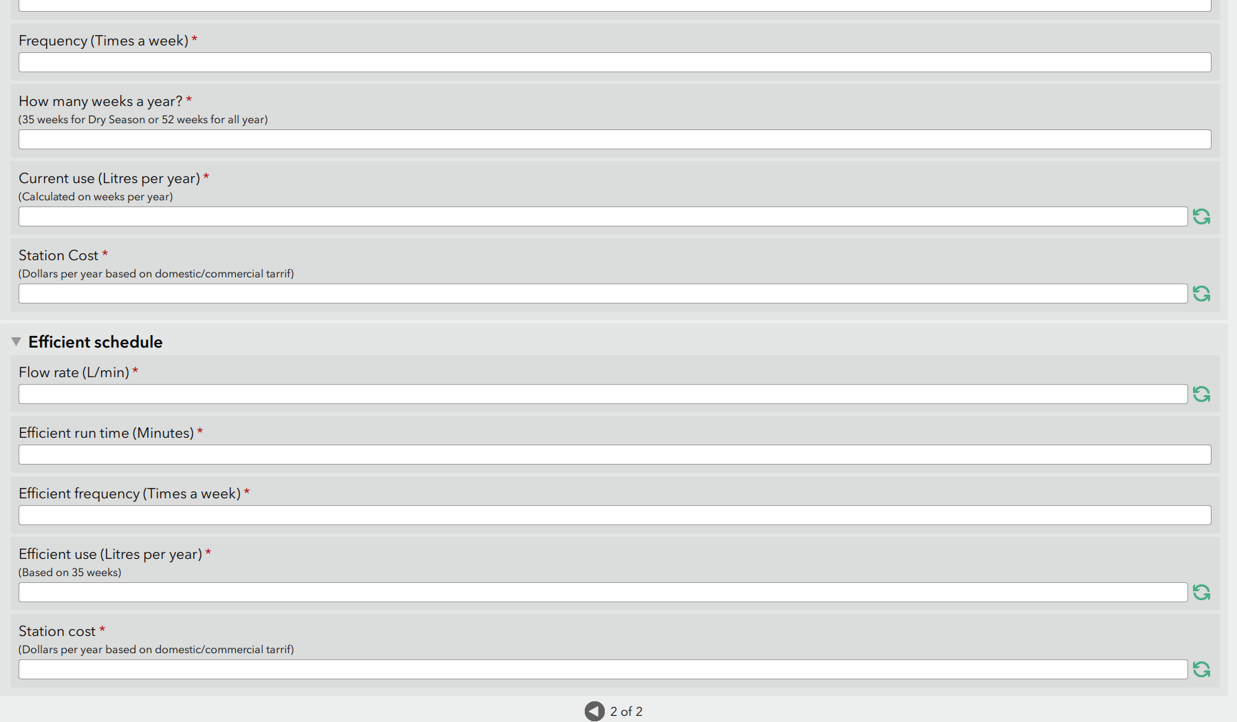

Hi Guys,
Hoping you can shed some light
I have a survey with a repeat, and the calculations don't seem to work automatically unless I have a default populated. In this case '0'
Problem is, that I can't put a default on the repeat? or can i?
Kind Regards,
Alexcalcs not working automatically.

Hi Alex,
I had a look at your survey and tested with latest beta build available on EAC, which include some enhancements to repeats and calculations, it appears with latest builds your survey and calculations in repeats are working correctly. In doing so however I noticed that the calculations inside the repeat reference the other questions inside the repeat that are being set to a default of 0. The calculations will not work on load if it is trying to multiple by 0. Once a new value is entered the calculations work so you need to update the calculation to take this into consideration, or it can only be updated once the values are not 0.
On top of that, we do have a known bug for repeat count and default values not populating on 2nd repeat rows or above. The 1st repeat records works as expected, but not the others. I have added your comments and survey example to this issue for further testing.
Can you test your survey with the latest beta builds available on EAC and let me know if you are still having issues with calculations and defaults.
Phil.
