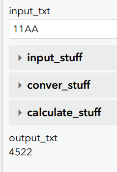

While java can do this with less steps, not everyone can use Java in their environment. To do this inside of S123 natively, you can use the attached (at least as a starting point).
input_txt
Your HEX input (only built it for 4 digits, but didn't add a bind::esri:fieldLength).
input_stuff
These calculates isolate the positions of the characters. E.g., substr(${input_txt}, 2, 3) will grab the third character of the string within input_txt. It starts from 0, and reads left to right.
convert_stuff
Will convert the alpha character (A to F) into a decimal number (10 to 15), or return the decimal number (0 to 9) without changing it.
calculate_stuff
multiplies the number by 16^x, where x is the position (This will explain better than me)
output_txt
Your decimal output
S123:
Verification:

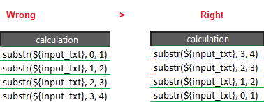

Two things:
  1. You can simplify what I have done. I just have all the steps broken down and visible like that so you can see what it is doing. I also stopped at 4 digits because the pattern should be visible from that point.
  2. I kind of messed up my original workflow. The 4 calculates under the input_stuff group were originally in reverse order. Rather than redo everything, I choose to swap their order (see below), which fixed everything. I am telling you this because, unfortunately, this adds an extra step for anyone that wants to expand this beyond 4 digits. Sorry!

abureaux
MVP Frequent Contributor
input_txt
input_stuff
convert_stuff
calculate_stuff
output_txt
Your decimal output
S123:
Verification:
Two things:
