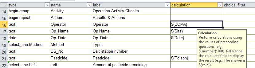

I'm having a problem with hidden fields within a repeat.  Users indicated quite strongly they didn't want to fill in the same answer over and over again in a Repeat question.  In the Repeat I used the Calculation function with ${Field Name} to copy a previously entered answer from the parent table to the child table (for our database purposes).  It worked perfectly in testing and database functions were built around all relevant data being in one row.
Calculation in the xlsform

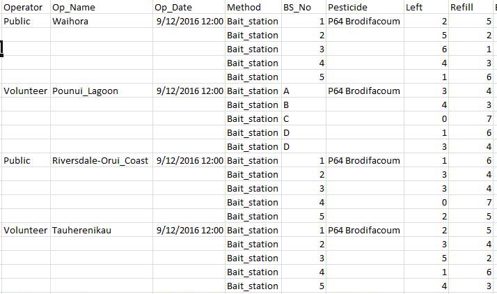

The same form created with Survey 123 Connect Build 1.7.35 copies the first repeat (1 of 1) but none of the subsequent repeats. Changing from Hidden to Text didn't seem to make a difference and Default doesn't work in Repeats..  Any ideas on when this will be fixed as we were planning to roll out to all users by the end of the month.
Output CSV example

Thanks for bringing this to our attention.  In terms of a workaround,it looks like 2 of your columns are the username (or closely related to the username) and date of the survey- by default, these are collected automatically via the editor tracking feature of the service, so you may not need these questions.  It would also be possible to calculate after the fact from either the parent table or non-empty child table using a script and the rowed/parentrowid relationship.
