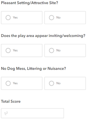

Hello,
is it possible in ArcGIS Survey123 web designer to create a calculation based on Yes and No values entered in something like a Single select type question.  The Yes values would have a value of 1 and No values 0.  I would like to add these up and perform a total score. Below is a mock up which hopefully helps.
Thankyou

ChristopherMcClain
The question type would be select_one list.  On the choice tab you can either modify the existing yes no choices by changing the value in the name column to 1 for yes and 0 for no, otherwise you could just create a new entry with the same values (depending if you will have other Yes/No questions in your survey that you don't want to do math with).  The you would add and integer , hidden, or calculate question type to the form and populate the calculation field with the ${fieldname}+${fieldname2}...  .  If this field will be visible to the user you will want to prevent them from overriding the calculated answer.
I have attached a quick example which I have attached
