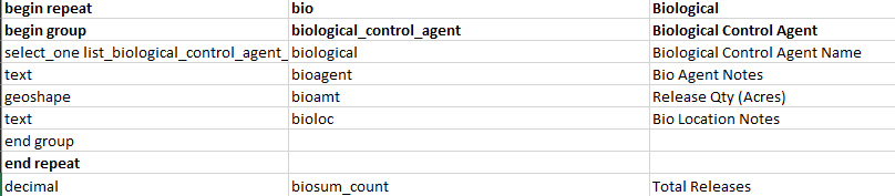

Is there a way to obtain a sum from a repeated group of the Area calculated from a geoshape feature? I originally had this as a text feature, but thought it would make it easier for the end user to draw out the area of biocontrol agent being released, but then that messed up the Total Release calculation I had. I found a different post addressing a similar situation and tried the join() instead of sum(), but that didn't seem to work (came back with coordinate data), so maybe I didn't set the join formula correctly? See snap shot of the table I'm working with.
TIA
this is the formula I had for a join, for biosum_count:
| join('; ', ${bioamt}) |

Do you mean calculate the area of each polygon, then sum all those up across all repeats?
If so you can use a field with a area calc inside the repeat.
decimal field type calc: area(${name of geoshape field})
Then outside the repeat use sum(area field above) to add them all up.
Great post on all of this here https://community.esri.com/t5/arcgis-survey123-blog/survey123-tricks-of-the-trade-lines-and-polygons...
Hope that helps
