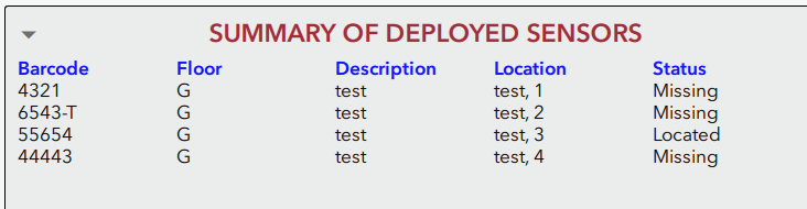

Results would look something like below. This way, the tech will know which samples are outstanding.
