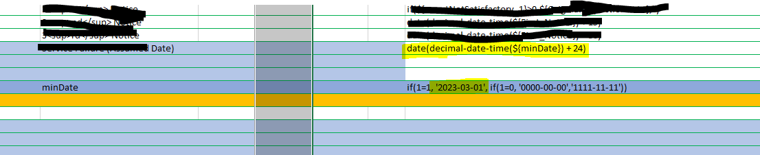

Every time a survey is submitted, I need to calculate a date that is always 24 days after the 1st day of the next month. (the expiration date)
I managed to do the following but I need to update the date in yellow every month, and I am afraid if I forget only once everything will go wrong.
Is there a way I can set a "next month" rule?
Thanks!

Hi @ZacharySutherby ,
thank you for your reply.
The date in that field is created only once and it never changes.
The record is an inspection that will be updated with other surveys but that Date field stays the same until the case is closed (the case is closed when that date passes).
If today, or any day of this month, I run an inspection, the date recorded in that field is the 25th of February.
For any inspection run in February, the date recorded in that field is the 25th of March.
(the date in my screenshot is updated already for the inspections of February)

Could you check if replacing the manual date ('23-03-01') with the following expression works (for minDate)
EOMONTH(TODAY(),0)+1

You got exactly what I need but I am struggling with the function.
is that "eomonth" function supported?
If I replace with this:
if(1=1, 'EOMONTH(TODAY(),0)+1', if(1=0, '0000-00-00','1111-11-11'))
The calculation results in a string: 'EOMONTH(TODAY(),0)+1' not a date
this means that when I try to add 24 days to my date field field I get an error.
(also tried to bind the field as date but nothing).
I also tried the following, instead of the previous string:
date(decimal-date-time(eomonth(${inspection_Date},0)+1)) , not sure if it make sense, but I get a error in calculating the expression.
