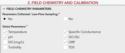

  4. Optional: Use the "relevant" column to dynamically show content in the group. In my case, I allow the end user to customize which data is visible (see image below). To save time in the field, I have defaults selected, according to our SOP.abureaux_1-1740500627864.png

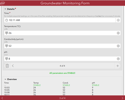

I have a similar chart for GW monitoring... Unfortunately, a linear list is the best solution I could find.
Here is an example from one of the low-flow sample sheets. Likely similar to what you are doing. The parameters are select-able on the previous page (I only selected a few for the sake of screen shots).

Fun fact about the grid implementation though! You can actually use the syntax in non-grid surveys. You are limited to columns of identical width, and can only add columns to groups, but it still works wonders. Just add w# to a group's appearance (e.g., w3 will add three columns to a group). This is what I am doing for the "Overview" section:
EDIT: It can be applied to Groups and Repeats. I forgot to mention repeats above...
