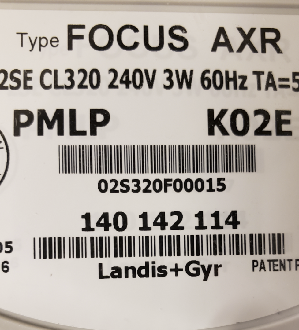

Before the recent update of Survey123, I tested successfully reading the barcode of our electric meters nameplate  using the Barcodes sample survey available in Survey123 Connect (version 3.9) and the android mobile app. This is the barcode that I'm trying to scan:

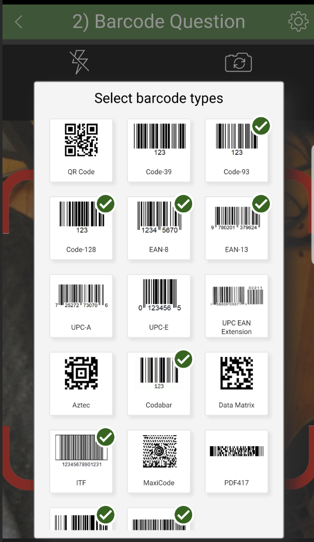

Also, the article mentions that: If scanning fails, the first thing to check is if Survey123 is configured to scan the type of barcode you are targeting.  Use the menu button in the top-right corner to configure the scanner.   You can configure the barcode scanner to scan any of the supported types if you like.
I selected all the options available in the menu option with no change in the result. I was surprised that I could not select all the types at the same time, as I tried to select them one by one some of the previously selected lost their selection. Also, the list of barcode type available after the upgrade is the same the was available before. So, it doesn't look like the barcode type I'm trying to scan was removed from the list.

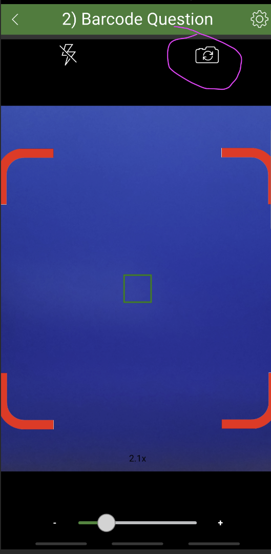

In addition, I had another problem with the rotate camera button. After clicking it once the camera rotated to the front facing camera and it won't change to the back camera when clicking it again or closing and opening the app.

I am looking into your issue and have done some initial testing with the two barcodes you provided. Using the field app 3.10 on a Samsung S20+ Android 10 and Samsung S8 Android 9 I am able to successfully scan both barcodes using the Code-39 barcode type. Tested with on screen and printed paper version of your two barcodes. I also can not reproduce the camera switcher issue, I am able to switch back and forth between both cameras.

As for the barcode chooser, all barcode types can be selected at the same time expect for Code-39 and PDF417. These two are mutually exclusive, as they are higher intensity and use a special scanning method. If you select one of these types then all other types are deselected. Note there is a small trick to select all quickly, press and hold on the "Select barcode types" to select/deselect all in one go.

Just an FYI, one of my colleagues has a Samsung S9 Android 9 and I asked him to test 3.10 with the barcode scanner and your 2 barcodes above, and he was able to scan them successfully and quickly, worked as expected.

I uploaded a video showing the problem with the Galaxy S9. You will see in the video that Survey123 in the
S9 has all the permissions. I was able to capture the barcode but takes several tries, and also the problem with the
switching from front facing to back facing camera is shown as well.

After recording the video I removed Survey123 from the S9, clearing the cache and the data, re-started the S9 and re-install
Survey123. The problem with switching the camera was still present in the Barcode sample survey, and the difficulty to scan
the test barcode persisted. Additional, I tried deleting the Barcode sample survey and download it again to the S9. This
reset the camera to the back facing but when I clicked to switch to the front I couldn't switch it back.
