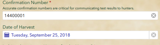

I am using the pulldata() function in the calculation field to autopopulate several survey questions based on the answer to a question regarding a confirmation number. It works great except for the date field I need populated. It will populate a date, but it is a day earlier than the value provided in the .csv file (confrimations.csv).
Here is the formula I used in the calculation field:
pulldata('confirmations','harv_date','conf', ${conf_no})‍
Here is an example of the confirmations.csv with only 1 row of data.
id,conf,county,harv_date,sex
10168797,14400001,Davidson,09/26/2018,male‍‍
When I enter the above confirmation number, this is how it populates the date.
Any ideas? Survey123 for ArcGISJames TedrickIsmael Chivite#pulldata()‌

Hi James,
Are you in the western hemisphere?  If so, a likely reason you are seeing this behavior is that the date string, with no other information, is being read as a date/time combination in UTC time.  If you change the date to a datetime, you should see the time register as your UTC offset in hours before midnight (as a date is being interpreted as occurring at midnight UTC).
One way to compensate for this is to add subtract the UTC offset from the number as interpreted as a datetime - see the attached sample.

JamesKelly4
That worked! Thanks again James Tedrick‌!

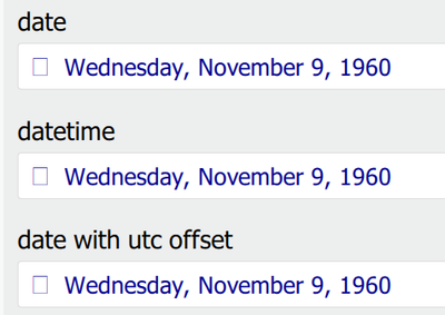

Hi @JamesTedrick  -
I know this post is years old, but hoping you see this. I am having the exact date issue as @JamesKelly4  in my Survey123 form - a DOB pulled in from a CSV file is 1 day off (always the day before). I used your XLSForm above as an example but this did not work - the incorrect date is still being pulled in. Do you have any suggestions? I am really struggling with this one.
After adding all of these new fields/calculations into my XLSForm, this is what happens when I test. The date should be November 10, 1960.
Thank you,
Erica
