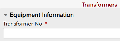

Hi ESRI Community!
I have a substation inspections survey that has multiple repeat groups, and each repeat group starts with an identifier, for example, "Transformer Number". Our end users have complained about populating the identifiers for all these repeat groups manually, and I was wondering if there was a way to automate it for them.
Essentially, Is there a way I can get the number of repeats and their identifiers to adjust automatically based on what substation is being inspected? For example, for a substation that has 2 transformers, I'd ideally like for the user to select the Substation Name, have the survey automatically add 2 repeats for each transformer at the substation, and auto populate the first question of the repeats with their associated transformer numbers.
Is this something that's achievable? Any help is appreciated. Thank you all!
