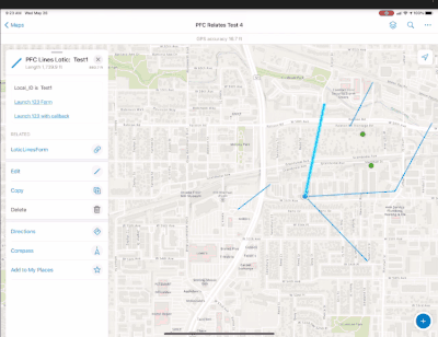

To populate asset ids I pass them from Collector/Field Maps to the forms.  Then the relationship classes ties them all together.  Even been experimenting with callback urls.  See here where it launch 123, passes in the test id then goes back to Field Maps automatically.
