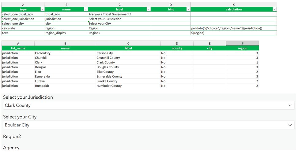

I have a select_one question asking for County. Based on that selection, I want to calculate/assign a Region. I want that Region to be auto-populated based on the County selection.
what I currently have in the calculation cell: pulldata("@choice",'region','name',${jurisdiction})
Survey design and results:region.png
See what I am doing wrong?

You’re very close. The issue is that your pulldata() syntax is incorrect for XLSForm. In pulldata(), the second argument must be the column you want returned, not "@choice".
Correct Syntax
Use:
pulldata('region','region','name',${jurisdiction})
Explanation
pulldata('file','column_to_return in the csv','lookup_column in the csv','lookup_value')
So in your case:
  • file → region (the name of the CSV file without .csv)
  • column_to_return → region
  • lookup_column → name
  • lookup_value → ${jurisdiction}
Meaning: Look in the region.csv file, find the row where name = selected jurisdiction, and return the region value.

GeoWorld13
@hmorgan thanks for the reply! That worked!
