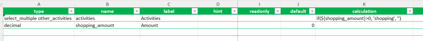

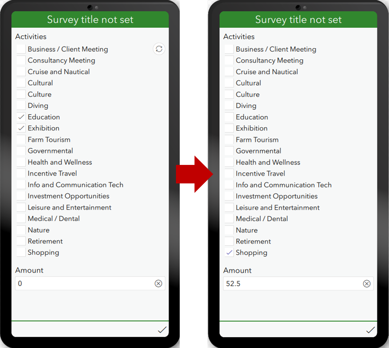

My XLS form looks like this (Please see Figure 1). This is just a part of a long survey form. The "Shopping" choice is automatically selected if Amount > 0. However, my calculation will automatically clear out all other choices selected by the user in the Activities question and only checks the "Shopping" option (Please see Figure 2).
Figure 1
Figure 2
The requirement is to keep all choices selected by the user in the Activities select multiple question type then if the user forgot to select the "Shopping" option, it will automatically be selected also if the an amount > 0 is entered in the Amount decimal question type. I have also attached my XLS Form for reference.

Hello,
Sorry to say that will not work as currently lain out.
You can get that functionality, but only if no human choices have been made to that select_multiple. The calculates required to get that functionality will not work when another non-calculate choice has been made (which you indicated was a requirement).
But if you are automating that one value, why not just remove it from the larger select_multiple entirely?
