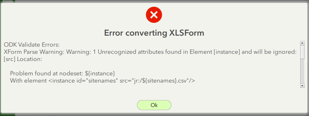

Claire_Peterson
Johnathan, I have been trying to get the pulldata () function to work but I keep encountering an error. Is it possible to use a csv to populate a drop down for a text field? Also, is it possible to have the pulldata() function work if the csv only has 1 column listing out all the site names?
I am quite lost
JohnathanHasthorpe
Hi Claire, pulldata essentially does a lookup against a .csv so is not the function you need.
In your case, all you need is a select_one question (with appearance set to minimal).
If you want to add new site names, all you need to do is to add new rows (site names) into the choices tab of your survey and republish. This will not result in any loss of data.
