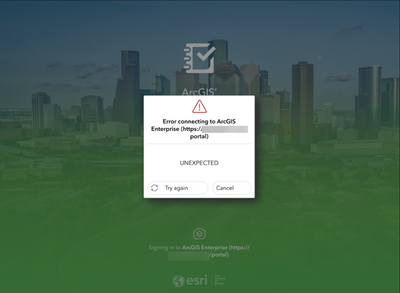

I am attempting to include the ?portalUrl= reference in links which are used to open the Survey123 app on iOS devices to direct them to the correct Enterprise portal. However I notice the following behaviour:
  • If the user is already logged out, and Survey123 is closed then arcgis-survey123://?portalUrl= works fine.
  • If the user is already logged out, and Survey123 is open then arcgis-survey123://?portalUrl= fails to sign the user in.

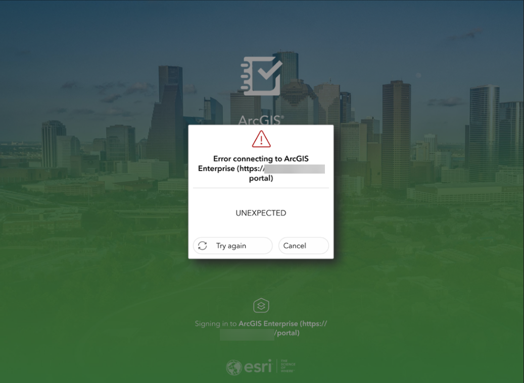

  • If the user is logged in to a different portal, and Survey123 is open or closed then arcgis-survey123://?portalUrl= results in the below error. The app must be closed and the link used again to successfully reach the correct portal.
Is this known behaviour @JamesTedrick or @IsmaelChivite ?
