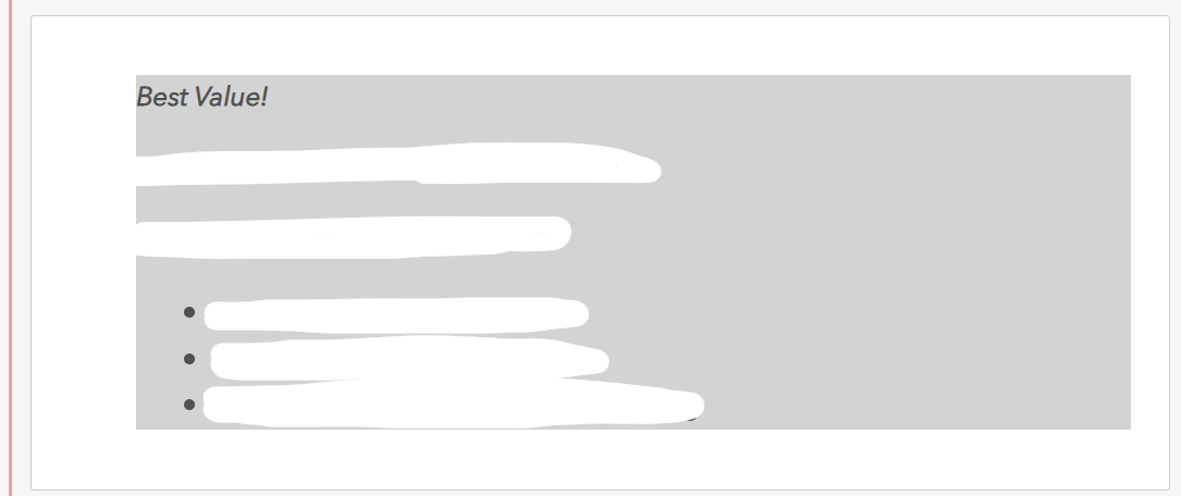

Hello ESRI Community!
I was wondering if anyone could assist me with this issue I am facing. I am looking to adjust the background color of a single list item in my survey 123, using the below HTML in the "label" column of my item in question. I also included a screenshot of what this HTML returns, and as you can see the lightgrey color does not cover the entire item box, just a small portion of it. If anyone knows what the issue may be, or has any suggestions on how to fix this, that would be greatly appreciated. Thank you!
<div style="background-color: lightgrey;">
<b>
<p> <i style="color:black; text-align:right;" >Best Value!</i></p>
<p style="color: red; font-weight: bold;">
RF -- $xy.xy/mo
</p>
<p> This is a great choice for:</p>
<ul style="list-style-type: disc;">
<li>bullet item 1</li>
<li>bullet item 2</li>
<li>bullet item 3</li>
</ul>
</b>
</div>

The actual item's background is controlled by the survey's theme. You're only controlling the appearance of the text area in your item, so it will always have a margin around it, and I don't really see a way to avoid this without changing the theme's settings directly.
You could at least add some padding to the HTML elements so the grey doesn't come right up to the edge of the ext.

Hi abureaux! Thanks for the response, I realize the way I asked this question may have been confusing. The bulleted list in the HTML I gave above is a part of the single answer choice I wish to change the background for. So I would want that entire code block to have a grey background, like in the screenshot I provided above, but fill the entire box instead of just the text area of the item. I appreciate your assistance however as this may come in handy in the future!

@emorenoI think that S123 is missing the HTML required to make that happen actually. So, S123 uses HTML for formatting, but it isn't a complete deployment, meaning there are items we don't have access to/don't do anything.
This was the closest I got:
Using this:
<div style="background-color: lightgrey;font-weight:bold">Best Value!<br><span style="color:Red">RF -- $xy.xy/mo</span><br><br>This is a great choice for:<ul><li style="background-color: lightgrey">bullet item 1</li><li style="background-color: lightgrey">bullet item 2</li><li style="background-color: lightgrey">bullet item 3</li></ul></div>
My suggestion would be to just toss everything into a Group, then color that group. That should give you what you are looking for:
<div style="font-weight:bold">Best Value!<br><span style="color:Red">RF -- $xy.xy/mo</span><br><br>This is a great choice for:<ul><li>bullet item 1</li><li>bullet item 2</li><li>bullet item 3</li></ul></div>
