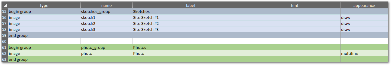

The existing survey has 3 sketch fields and 1 photo field:
Following the (guessed) photo naming convention in the ATT_NAME field of the in the __ATTACH table,  I have named my attachments using the following the naming convention:
photo-YYYYMMDD-HHMMSS.jpg where photo is the question field name

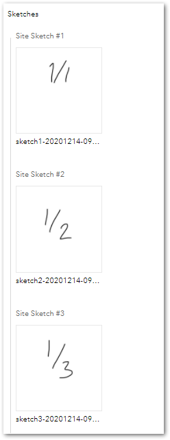

For example, the attachments for a record entered though iOS are correctly classified under the headings "Sketches" and "Photos"

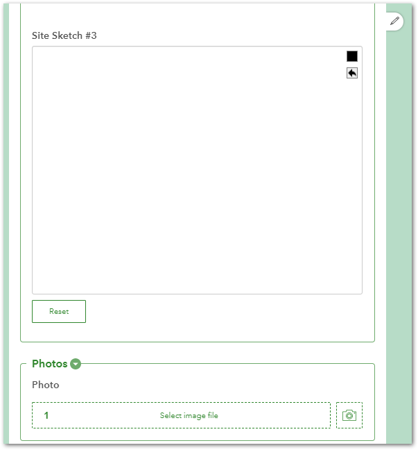

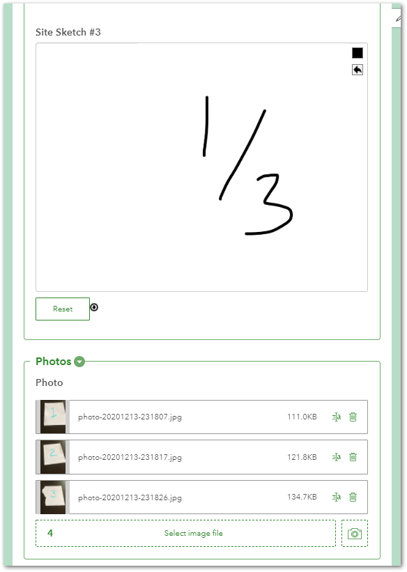

Similarly, using a URL call to edit the records from a Dashboard, a record loaded via the iOS app displays Sketches and Photos in the web form:
But records loaded via Append in Pro have only the attribute data correctly loaded.  The attachments are loaded but they are not recognized as such :
