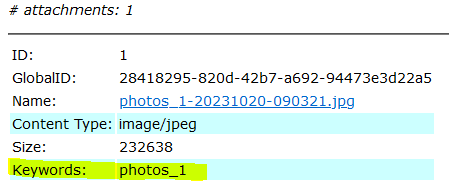

The key to getting the Survey123 report to recognize an uploaded image to a specific (survey123) image field, is for the uploaded image to have the name of the image field on the 'Keywords' property of the attachment.
I don't think there's currently any way to specify this property either through ArcGIS pro, nor the built in add attachment functionality on AGOL/ Portal for ArcGIS.
However, you CAN specify this parameter either in the ArcGIS Rest API:
https://developers.arcgis.com/rest/services-reference/enterprise/add-attachment.htm
Or using the ArcGIS API for Python - AttachmentManager.add()
https://developers.arcgis.com/python/api-reference/arcgis.features.managers.html#attachmentmanager
I've included a very simple python script as a sample of how it may be used.

Raul
