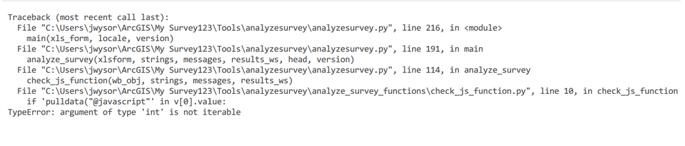

I am trying to use the Analyze survey tool in Survey123 Connect (v. 3.18.123).  I get the following error when it is run:
JimW_0-1693235777109.pngI have analyzed several other surveys without issue.
What's going on?
Thanks.

Do you have a value in your calculation column that is just a number? Would you also be able to pass along your XLSForm for review on our end?
What's likely happening is there may be a value in the calculation column of your XLSForm that is an integer and the tool is failing because it's trying to compare a string to that integer. If this is the case this is a bug on the tool side.

I found that if I run the tool with my XLS file still open, I get that error.  If I then close, the tool runs.  I also update the XLS form if it's an older version.
Regards, Jay

Unfortunately, my XLS file was already closed and I already updated the XLS form to the latest version.

That was the issue.  I had the number "1" in my calculation cell.  I deleted it, ran the analyzer, fixed my file and then added the 1 back into the file.
