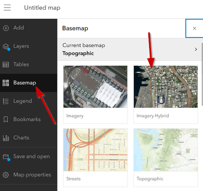

If it's a layer you retrieved from the ESRI public layers, it may have had its permissions changed for either it going private or an update. You may need to enter the map, remove the Bing Maps Hybrid layer, and then add a new hybrid layer through the Basemap option here (if it's a basemap):
Otherwise if it's not a Basemap, you may need to remove the problematic layer, and find an alternative if the permissions cannot be changed.
