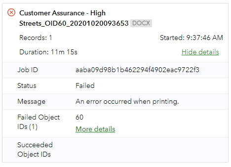

To find the failed job id, you need to go to the Survey123 Website Data page, open the report panel, click Recent tasks button on the bottom, and view the details of the failed task which will let you know the failed object ids:
Then, you can use the filter tool on the data tab to filter the data.
