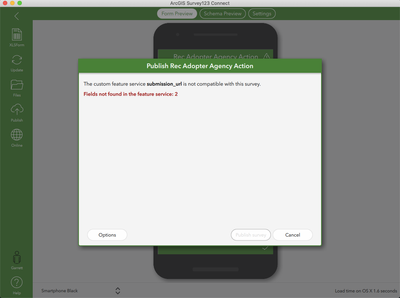

I am trying to add two new questions (fields) to a survey that was published last year that points to a hosted feature layer and three tables (forms). After adding the fields in the XLSForm from Survey123 Connect, I get the following message:

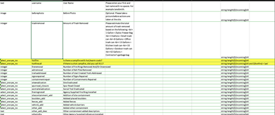

Here are the two fields I am trying to add, highlighted in yellow:
Do I need to add these fields in the form first?
I have seen other posts, where people are able to add fields when publishing the edited survey, but I am not receiving that option when I try to publish.

I deleted all the Feature Layers (hosted and view) created from the Feature Layer that the surveys were pointing to and I was able to add new questions tot he surveys successfully.
Thank you for all of your help.
