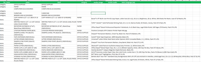

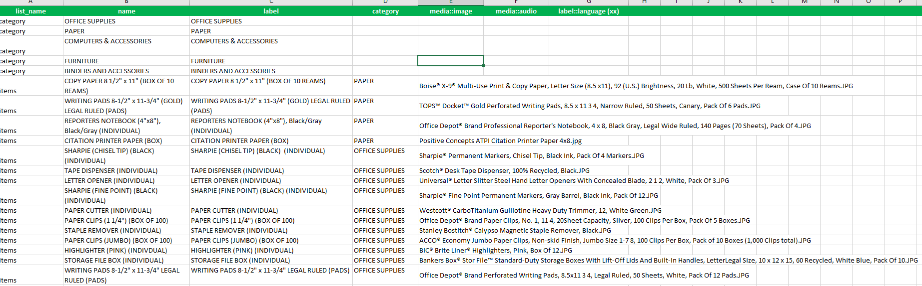

I have a form on Portal that I am adding images to that causes the form to display the "ot accessible or exist" page. I remove the .jpg files from the media:image field in connect, republish and I have access to it. What am I doing wrong adding those images. Please see below for screenshots. Thanks!

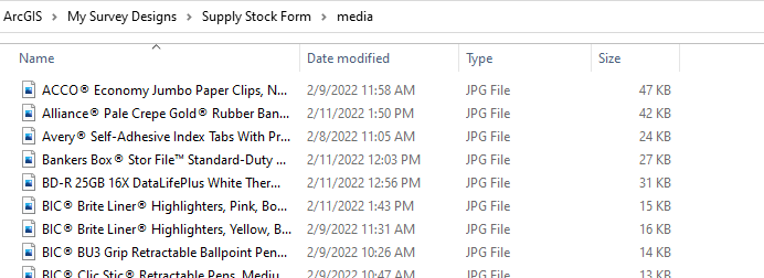

If I remember right Images can have no spaces or special chars for sure in the name.  Not sure how you got all the in a file name really.  Best not to ever use special chars.  Take all that out and see.

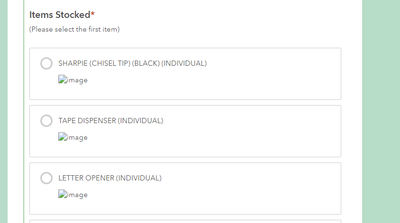

I believe that corrected the access issue but they are still not showing up on the web browser survey. Do you have any ideas there? Thanks!
