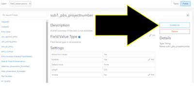

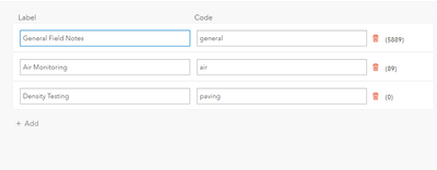

DerrickWestoby
You should be able to add it via the AGOL interface for the feature layer, too.  I've done this when updating published surveys with new select_one or select_multiple questions created from a new list.
(As others have said, back up your feature layer before doing this)
Update the list with the exact values you have in your list in the Survey123 XLS form.
