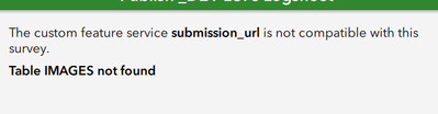

I am running into a problem where I want to use the InBox to edit existing features in a feature service. I crated my survey from the feature service. As I tested the resulting survey, I discovered the issue where I am not able to add photos. Looking through GeoNet, the solution is to nest the image question in a repeat. I edited the Excel spreadsheet with the repeat and tried to republish. I received a "The custom feature service <submission url> is not compatible with this survey (Table <Table_Name> not found). I am assuming that I am getting this error because I did not create the feature service with the table. Has anyone else run into this issue where you need to add a repeat/table to a feature service created outside of S123, and you can't because the table is not already created? I tried a bunch of solutions and none of them have worked so far.

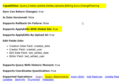

I am trying a similar thing but with a NON-Hosted Feature Class...
  • I created a S123 Form and published it.
  • I then registered a Feature Service in Portal that has the same schema as the form
  • I then updated the Submission URL to point to the Feature Service ID in Portal that points to my SDE Feature Class via Portal. and republished the Form from S123 Connect.
This works great.... and the SDE data is being updated.
Now the parameters of the project changed and I need Multiple Images not one like the form originally had.
  • So I thought I would just go into the S123 Connect and add a Repeat around the image.
  • I added the Repeat around the image and tried to Republish
I tried this and got an error ... The Feature Class/ REST Service  should be fine... At Has Attachments Enabled and this
