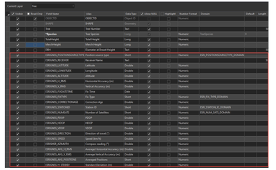

Just add the new fields via S123 Connect. Here are the GPS-related fields:
But if you are on Web Designer, you will be limited on what can be collected for GPS data. You basically just get location data:

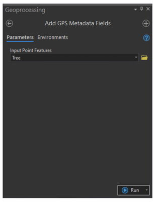

  • Open the Add GPS Metadata Field tool from the toolbox.
  • Browse to the point feature class or feature service you want to add the metadata field to.
  • Run the tool.
  • Right click on the feature class or feature service and choose Design> Fields.
  • The new fields will be visible.

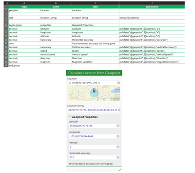

Survey123 Connect
Survey123 Connect will use the pulldata function in the calculation field to extract the GNSS metadata information from the geopoint field type. Metadata extraction will not be available if you are building surveys in the Survey123 Web Designer.
Let’s take a deeper look into the pulldata formula for extracting Latitude.
  • The formula command will be pulldata()
  • The “@geopoint” parameter in the formula extract information from the geopoint field type in the survey form.
  • The ${location} parameter is pulling the name of geopoint field type that hold the actual geopoint value.
  • The “y” parameter is defining the geopoint parameter that you will be extracting.
  • GNSS metadata field can be turned to read only to prevent users from editing the values.

I was able to add the `GPS metadata fields` using the `Add Metadata` tool in ArcPro, but i guess it's not yet possible to auto-populate these fields in the web designer.

Survey123 Connect
