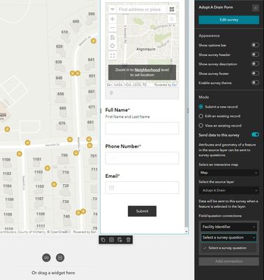

This can currently be done by using the survey widget in Experience Builder.
Refer to the following Blog.
https://www.esri.com/arcgis-blog/products/experience-builder/real-time/using-experience-builder-and-...
Heena1
Hi @BrandonArmstrong
Thank you for sharing your experience!
I read your blog and tried to configure, but it doesn't work for me. I am trying to send attribute information from one feature layer to the survey feature layer. No selectable fields are showing in the configuration. How did you set up in Experience Builder?
Catherine_Hodde-Pierce
I am having the same issue as Heena.
chiara_c
Hi @Catherine_Hodde-Pierce@Heena1, were you able to solve the issue?
Thanks.
