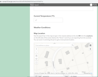

Hi @JamesTedrick @DanielStoelb @ChelseaRozek ,
I am using pulldata function (pulldata("@json", ${jsonresponse}, "weather[0].main") ) to pull weather data from https://home.openweathermap.org/.
I plugged the weatherkey code (32 characters) into the default field in the Survey123 form to pull weather data. Its working fine in survey123 app but its not working on Survey123 website. I changed the survey from Public survey to private, still no luck.
I will appreciate if you could help me.
Here are the screen shots
Thanks
StanislausCounty
We've run into this a couple of times; use the inspect tool in your web-browser to see what, if anything, is failing. When this has happened to us it had to do with how tokens were being handled or how the attribute names were entered. In the attribute case the names had to exactly match the attribute column names and not the alias (e.g. exact capitalization). For whatever reason the app was able to tell what we were referencing but the browser version was not.
