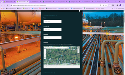

I would love to be able to resize the map (or maybe even the entire survey area) for geo questions in the web app for Survey123. Another option would be to allow the user to make the map full screen, like a popup. Right now, my geoshape question is pretty inaccessible to my end users, many of whom are older and/or have bad eyes and/or aren't the most tech savvy.
Look how teeny tiny that map is (screenshot below)! It's barely accessible to me, and I'm a map & tech professional.

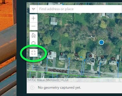

Hi @KellyTaylor
In the Survey123 web app, you can open the map in a full screen pop-up by clicking the Large map button on the map:
