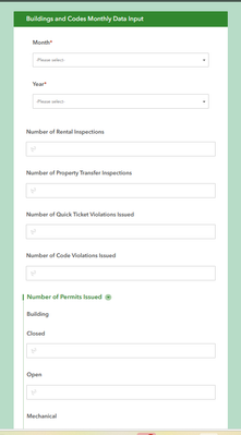

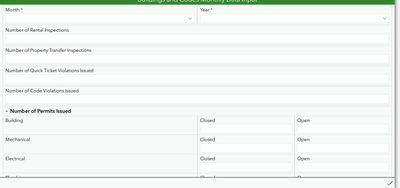

apgis16
@ChrisLeSueur I am trying to publish a survey with a grid layout from Survey123 Connect and have the users fill it out in their browser. When I publish it, it looks accurate on the S123 mobile app but the grid isn't there at all when I open up the form in the browser. Is this a limitation?
typenamelabelappearancebody::esri:style
notegenerated_note_form_title<p style="text-align:start;">Buildings and Codes Monthly Data Input</p>
begin groupmonth_year w4 field-list
select_one monthmonthMonthw2 minimal
select_one yearyearYearw2 minimal
end group
integernumber_of_rental_inspectionsNumber of Rental Inspections
integernumber_of_property_transfer_insNumber of Property Transfer Inspections
integernumber_of_quick_ticket_violatioNumber of Quick Ticket Violations Issued
integernumber_of_code_violations_issueNumber of Code Violations Issued
begin groupnumber_of_permits_issued_by_typNumber of Permits Issuedw4:1 table-listlayout=fixed-grid
note Buildingw2
integerbuilding_closedClosedw1
integerbuilding_openOpenw1
note Mechanicalw2
integermechanical_closedClosedw1
integermechanical_openOpenw1
note Electricalw2
integerelectrical_closedClosedw1
integerelectrical_openOpenw1
note Plumbingw2
integerplumbing_closedClosedw1
integerplumbing_openOpenw1
note Fire Protectionw2
integerfire_closedClosedw1
integerfire_openOpenw1
note Total Permitsw2
integertotal_permits_closedClosedw1
integertotal_permits_openOpenw1
end group
