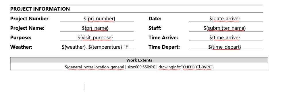

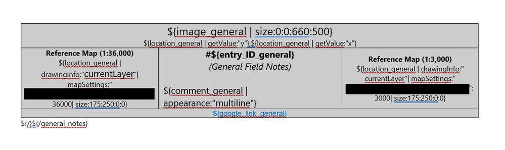

Hi @JZeeb_Tosv - You can do this right now!  Search for "currentLayer" on this help page
  Set up the symbology on your feature layer's visualization tab (not web map) to display an arrow and rotate based on an attribute value (make sure you're capturing the image direction in the form, and that it's a numeric field).  Then, use  "drawingInfo:"currentLayer" in your report template.

Report template (one map is a summary map for all repeats, the other is for individual records)
