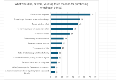

Currently, we are able to export the raw Survey123 data to Excel. This gives us the ability to analyze the data and produce charts and graphs that are manipulatable and transparent; you can go back to the data and see how the chart is being calculated. The "Analyze" tab produces excellent charts and graphs, but without the ability to connect the dots and see what records are producing the results.
Ultimately, if the intent is to share these charts with a client, they either need to be shared as a printout of the Analyze tab, or to be reproduced in a format that allows for further investigation - i.e, Excel. Neither of these is a great solution. I cannot investigate the charts in a printout, change their colors, labelling, etc., and to reproduce them directly from the exported data table is a time-intensive and frustrating process.

The data transformation and countby rigmaroleThe data transformation and countby rigmarole
Don't forget to sort your data or you'll end up with a messy chart...
Finally, the chart. Try doing that for 50 charts and you'll find it's a big pain in the butt.

DougBrowning
Take a look at ArcGIS for Excel.  You can direct link it to the 123 service and set it all up in Excel once then sync to get new data.
