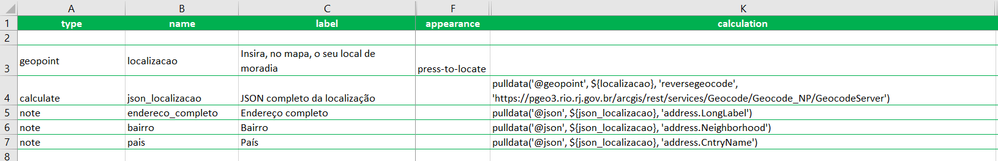

I was able to figure it out. I was including the ArcGIS online world geocoder URL in the statement. I removed the URL and now my calculation works:
pulldata("@geopoint", ${Last_Location_Geo}, "reversegeocode.address.Match_addr")

Is there a diffrence in using the newer ArcGIS Pro built Locator styles? I created a new locator with Pro and published to our Portal but cant seem to get a response in Survey123 Connect. I have tested the JSON from the service and can get a result back.
{ "address": { "Match_addr": ....
The calculation in the XLS form
pulldata("@geopoint",${location},"reversegeocode.address","GeocodeServe SERVICE URL")

hiddenreversegeocode_json_outputJSON Results multiline pulldata("@geopoint",${location},"reversegeocode","","featureTypes=" + ${featuretypes})esriFieldTypeString4000
select_one featureTypesfeaturetypesSelect output type (Address or Street Intersection)   <i>If other than street address</i>minimalPointAddress esriFieldTypeString50
textaddresEnter Address Not in List   pulldata("@json",${reversegeocode_json_output},"address.Address")esriFieldTypeString50
