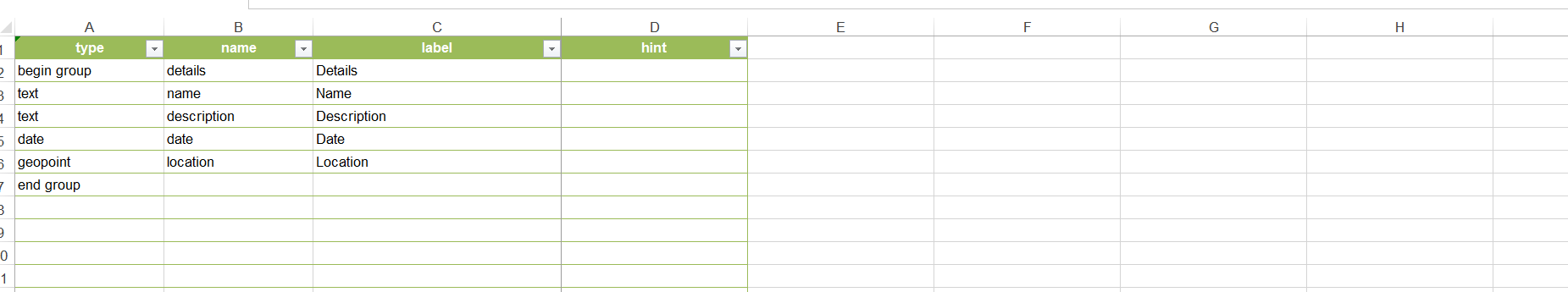

I downloaded the current version of Survey123 Connect.  When I create a new survey I now do not see the full heading options as prior?  They now stop after Column D, Hint?
RonKnepper
Got it, there is now a new form template and a blank version.  I didn't realize this, template has all the details.
