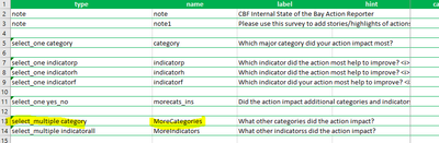

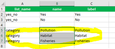

Very helpful for a total Survey123 beginner. One question: in the above calculation if(selected(${violations},'10'),1,0), where do the values '10','20' etc. come from? Are they the index values for the choices? Are they set somewhere else?
Thanks.
ETA I found it in another blog post on multiple choice items. They are set in the list choices' "name" column.

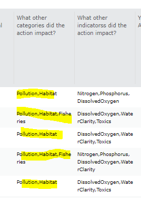

@IsmaelChivite I have had an issue with using select_multiple question types and the submitted data shows as "thing,thing,thing" when I'd like it to show in the attribute table as "thing, thing, thing" to make it look cleaner to the final user.
Can I use the if(select()) calculation to insert a space between each selection for a select_multiple question or is an expression I can add elsewhere in the survey123 XLS form?

I'm triying to make a question appear when the user selects one option from a designated list in a previous question.
Right now I made it work with just one option.
Thank you!
