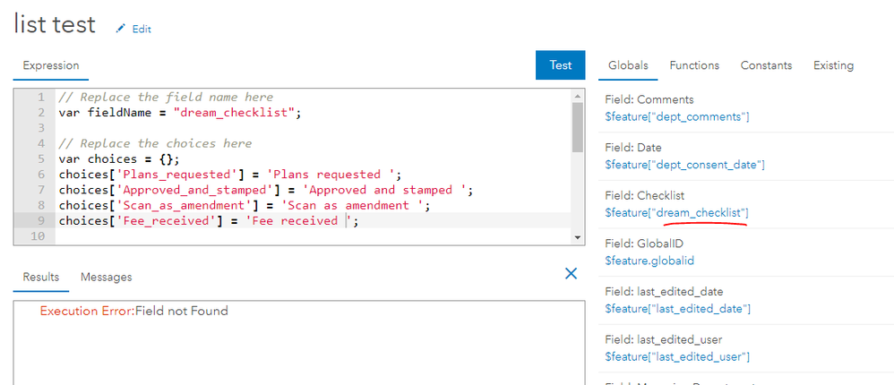

Hi James, I tried implementing this for one of my COVID webmaps. I keep running into this error:
Execution Error:Field not Found
I can call the field outside of the function so I can't figure out why the expression says it can't find the field. Any thoughts?

Hi James, thanks for your reply. I double-checked the field info on the feature service and it checks out okay:
essential_services (type: esriFieldTypeString, alias: What essential services does your business provide?, SQL Type: sqlTypeOther, length: 1000, nullable: true, editable: true)
Calling the field in the Arcade editor outside of the function also works. Do you have any other ideas why this might be happening?

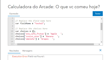

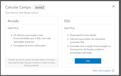

I am trying to replace a label name with @JamesTedrick  script on the arcgis plataform. But 2 diferrents things are happening:
1- First, when I publish survey form and colleted data there are created 4 arquives, one webmap, one feature layer, one form and one feature layer(stakeholder). I am not sure what is that stakeholder but it works as a mirror from feature. If any one could explain me what is that aboult I will be really apreciated!! Then, when I try to use the arcade it is just habilitaded on stakeholder, and not in feature layer. Any one knows why that is happening?
2- Second, when I try to use the arcade on stakeholder where the option it is habilitaded the script works on test but when it started to load something happen and all collumn values desapered and now when I try again to run the script shows me an error:
I am not sure if I explain right. Let me know if I need to leave here any more information.
If any one could help me, I will be really apreciated!!!

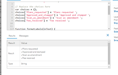

Update to Field not Found error...
it appears this Arcade snippet works only on the _stakeholder (now "_results" in 3.16) layer that is auto generated by Survey123
