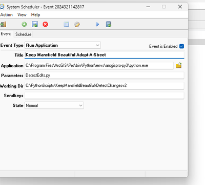

MansfieldGIS
I'm trying to run this email notification and I'm getting this error message
File "<string>", line 340, in <module>
File "<string>", line 29, in main
NameError: name '__file__' is not defined"
when I running  it straight  in ArcGIS Pro 3.2.0.  I have also set up a task schedul to automatically run
(see below)  it will not run in that.  I also have another notification script that I set up 1st  and that runs perfectly.  I just can't get the 2nd one running.
This is the one that is not working.
This one works.
any help would be appreciated.  Thanks
