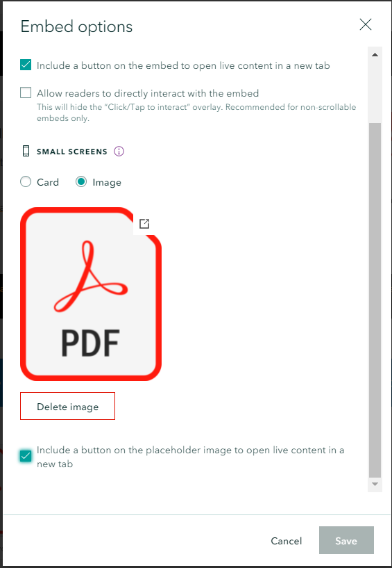

I've been using the Embed media item to add pdf's to a storymap. However, after adding the content and clicking on the cog/settings icon to open the Embed options, I am unable to save any changes to the embed options. The save button is greyed out. Is this expected behaviour?

I think I am experiencing the same issue. The embedded content works fine but when I try to set the "Alternative image for small screens", it won't let me save the image I try to upload.

I raised this as a support case with ESRI and it was logged as BUG-000142336.
The workaround identified was:
Publish PDF and Story map for Public use
Copy URL
Add Embedded Content
Select Card and scroll to Custom Card Details towards the bottom - toggle on
Enter text into the Title box - the save option should now be shown as available
Scroll up and Toggle on Image
Upload Image and click Save
Publish Story map and view on small screen
